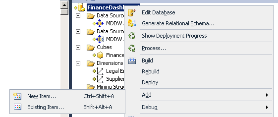

Rather than re-doing all the work involved in defining dimensions, I imported the existing ones by right-clicking on the project, and selecting "Add" -> "Existing Item":
