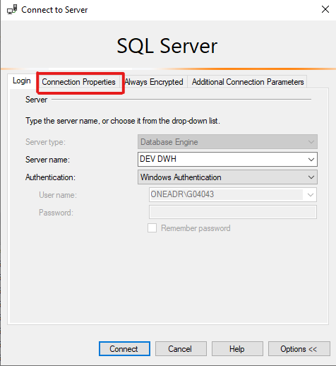

To avoid this, a fairly simple trick is to assign different servers with custom colours. To do so, when you connect to a server in SSMS, use the Connection Properties tab:

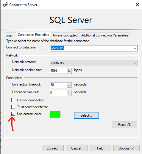

On that tab, check the box "Custom color", and click the Select button to assign a custom color. In this case, for DEVI assigned it with a green color:
