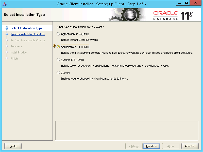

    Once that is done, you can use an ODBC or OLE connector to connect to Oracle. Ole DB is faster, but still slow. Luckily Attunity provides a blazing fast component. However, you might end up running into all kinds of issues, requiring you to set up registry keys in order for SSIS to pick up the proper ORACLE_HOME path, and even when that is done, you might encounter the following error:
    As it turns out, this was caused by me installing only the "InstantClient" installation of the Oracle Client Installer. Switching to the full (Administrator) version fixed the issue and allowed me to connect successfully.
